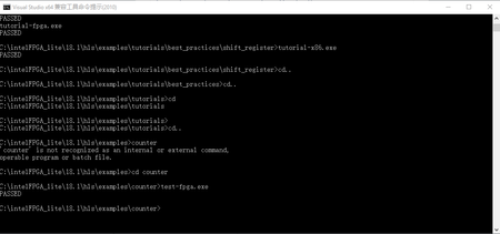

I have used Quartus lite 18.1 & MS Visual Studio 2010 on windows 10 environment.
example design of counter with Cyclone V device and followed session 8.1 from above link.

in my situation, refer session 7 was more useful than 8.1 from https://www.intel.com/content/dam/www/programmable/us/en/pdfs/literature/hb/hls/ug-hls.pdf.
You were right. My test-fpga.exe (test-fpga.prj) was created on Arria10. but I was trying to compile it on Cyclone IVE device family on QPLite. After your answer, i tried on CycloneV device and it compiled successfully. Thank you again.
