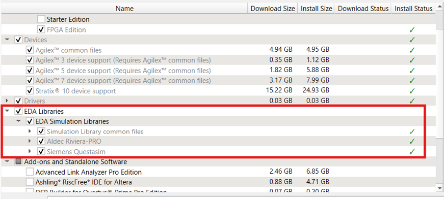

To fix this problem, make sure “EDA Libraries” has been checked and installed properly during installation of the Quartus® Prime Pro Edition Software, as shown in the screenshot below.
