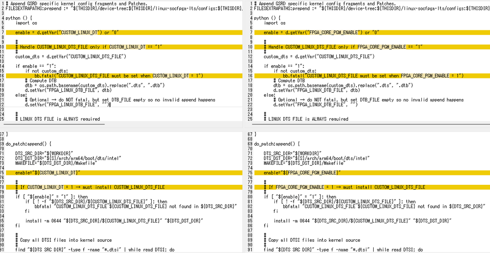

    As an experiment, I made the following changes:
    1) Modified the conditional check in the kernel recipe
    Before: FPGA_CORE_PGM_ENABLE
    After: CUSTOM_LINUX_DT
    2) Set the following in kas.yml
    CUSTOM_LINUX_DEVICE_TREE = "1"
    With these changes, the custom Linux Device Tree was successfully applied even when using FPGA Configuration First mode.

    For #1, your changes are correct. The explanation for existing implementation is because the HPS Baseline Example Design (aka GSRD) is running on HPS Boot First mode, and the custom device tree (baseline_a55.dts) is only configuring the FPGA part. We acknowledged the gap that if user is switching over to FPGA configuration first mode, the custom device tree will not apply. We're going to fix this in upcoming release.
