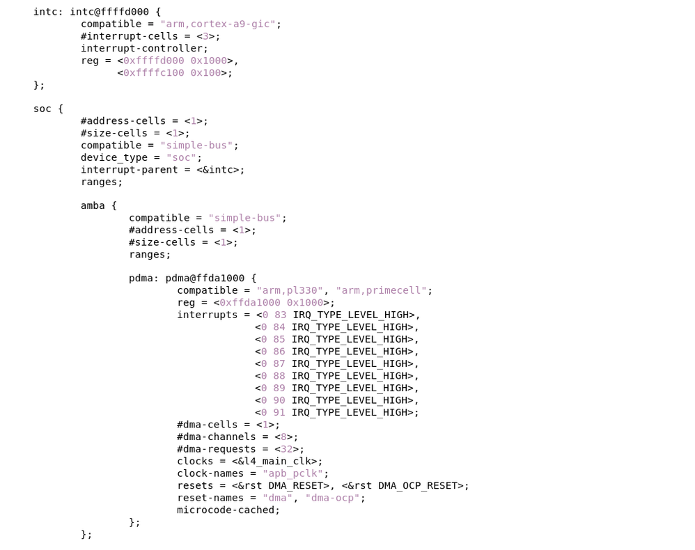

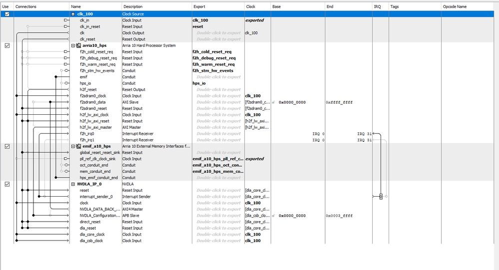

    I have followed the flow and now linux is running on HPS. But the hps2fpga bridges are not enabled. I have check /sys/class/fpga_bridges directory and it is empty.
    I think since the .dtb file (from linux source) we have, is a bare minimum device tree file and it explain only the harden device connected to hps, so it doesn't describe the soft IPs connected to hps over hps2fpga bridge or lwhps2fpga bridge. screen shot of soc node defined in dtsi file for arria10 in linux source is attached here. It shows that HPS_FPGA bridges are not defined.
    Actually, I am trying to integrated open source NVIDIA's Deep Learning Accelerator (NVDLA) with hps. soft IP of NVDLA is connected to hps in platform designer via lwhps2fpga bridge as show in the screen shot attached here.
    After device tree is create for this custom project, I need to build nvdla Kernel Module Driver (KMD) with Linux source code, before compiling linux kernel into compressed image (zImage). This kmd is also using a reseved memory region of 1 GB for running NVDLA jobs.
    So in conclusion I have three main issues I need help with.
    1. Creating device Device driver for any custom project.
    I have tried to follow a tutorial given on rocketboard.org for creating device using sopc2dtc command and board.xml files. I have contacted Terasic for board xml files for HAN Pilot Platform but they told me that they don't have xml files for Han. Still I tried using xml files of arria10 SOCkit but it didn't work.
    2. editing final device tree file to add node for reserved memory.
    3. How build KMD with linux kernel source code.
    I have also uploaded the above screen shots as attachment with this comment for your reference.

    I know this topic is quite old but I am just facing the same error (same hardware and ghrd) that my boot process got stuck on the line Waiting for root device /dev/mmcblk0p2…
    As proposed I am using the xml files located in the hps_isw_handoff folder to generate the device tree with the following command:
    sopc2dts --input a10s_ghrd.sopcinfo --output socfpga_arria10_socdk_sdmmc.dts --type dts --board hps_isw_handoff/hps.xml --board hps_isw_handoff/emif.xml --bridge-removal all --clocks
    I guess that those two .xml files are wrong or not enough to generate a functional device tree. Do you have any idea what the problem is?
    When I use a precompiled example .dtb the system boots successfully.
    Also I am wondering why Terasic claims that they don't have board files since they provide example designs where those files are essential?
    Thanks in advance!
