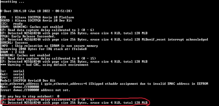

Hi team,
We are using Intel Arria 10 SOC 10AS032E2F29I2SG and QSPI flash for the boot source MT25QU01GBBB8E12-0SIT . During the booting time , the line gets stucked at SF: Detected N25Q1024A with page size 256 Bytes, erase size 4 KiB, total 128 MiB .
This happens intermittently and at some cases the booting gets completed.I have attached the log image below for your reference.
Please suggest to resolve this issue asap.
Thanks in advance.

    Please find the successful log below
    U-Boot 2014.10 (Jun 17 2022 - 20:49:44)
    CPU : Altera SOCFPGA Arria 10 Platform
    BOARD : Altera SOCFPGA Arria 10 Dev Kit
    I2C: ready
    DRAM: WARNING: Caches not enabled
    SF: Read data capture delay calibrated to 3 (0 - 6)
    FPGA: Early Release Succeeded.
    SF: Detected N25Q1024A with page size 256 Bytes, erase size 4 KiB, total 128 MiBemif_reset interrupt acknowledged
    Error: Could Not Calibrate SDRAM
    DDRCAL: Failed
    INFO : Skip relocation as SDRAM is non secure memory
    Reserving 2048 Bytes for IRQ stack at: ffe3a6e8
    DRAM : 0 Bytes
    data abort
    pc : [<ffe001cc>] lr : [<ffe02499>]
    sp : ffe3fff0 ip : 00000016 fp : 00000001
    r10: ffd02078 r9 : ffe3aee8 r8 : ffe00000
    r7 : ffe1d420 r6 : 00000000 r5 : 00000000 r4 : ffeff000
    r3 : ffe3afaf r2 : ffe40000 r1 : ffe3d000 r0 : ffe3aee8
    Flags: nzcv IRQs on FIQs on Mode SVC_32
    Resetting CPU ...
    resetting ...
    I2C: ready
    DDRCAL: Success
    DRAM : 2 GiB
    SF: Read data capture delay calibrated to 8 (0 - 15)
    *** Warning - bad CRC, using default environment
    In: serial
    Out: serial
    Err: serial
    Model: SOCFPGA Arria10 Dev Kit
    gpio_ethernet_address 1 gpio_ethernet_address+4 1Skipped ethaddr assignment due to invalid EMAC address in EEPROM
    Net: dwmac.ff800000
    Error: dwmac.ff800000 address not set.
    Hit any key to stop autoboot: 5 4 3 2 1 0
    Full Configuration Succeeded.
    SF: 6225920 bytes @ 0x120000 Read: OK
    SF: 32512 bytes @ 0x100000 Read: OK
    FPGA BRIDGES: enable
    Kernel image @ 0x008000 [ 0x000000 - 0x4dd360 ]
    ## Flattened Device Tree blob at 00000100
    Booting using the fdt blob at 0x000100
    Loading Device Tree to 01ff6000, end 01fff215 ... OK
    Starting kernel ...

    Also We have flashed this to many boards....and all are working fine...only one board having this issue.
    Please find the below env settings you asked

  • Aravind_18's avatar
    Aravind_18
    Sorry for the late reply.
    I have flashed this same bootloader to many boards and was found working. only one board has this boot stuck issue.
    I have attached the successful boot log and env settings.
