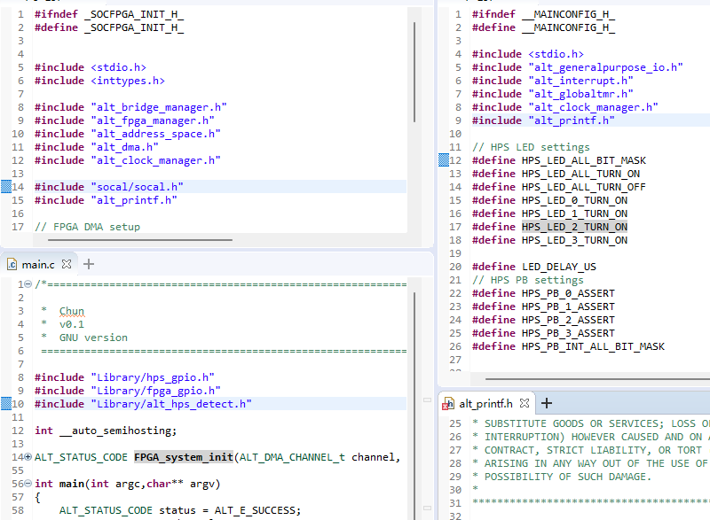

HWlib baremetal project issue: How to devide the codes.
forgive me to ask a foolish question:
How to devide the codes in the project.
I devided the codes into FPGA part and HPS part.
As you can see both header files contain "alt_printf.h" and "alt_clock_manager.h"
which cause the multiple compiling and cause a lot of errors.
Do you have any ideas to solve that problem?
Reguards.

    Hi Alex
    Including the same header multiple time would not be a problem.
    In the header files there are header guards.
    Could you share me what are the error that you are seeing?

      I deleted the project but the issue is
      alt_printf.c and alt_clock-manager.h have multiple definition.
      Now I wrote these codes in one file using GNU.
