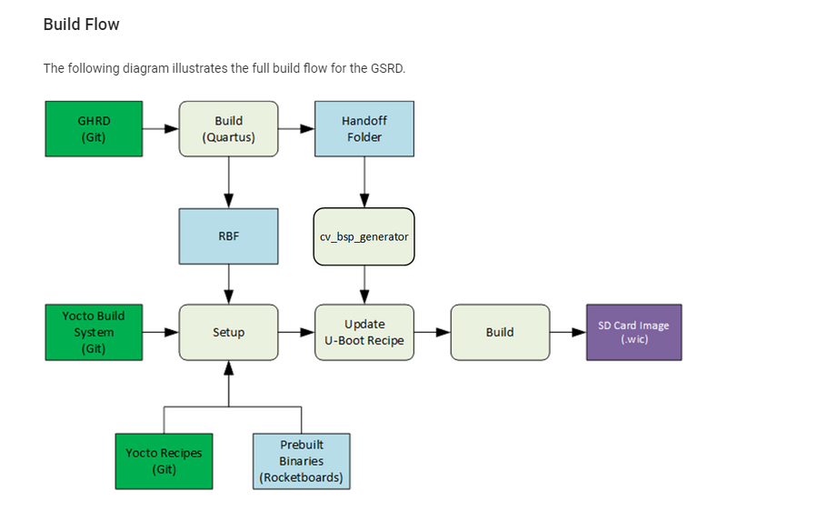

For FPGA image, you need to convert to .rbf to load together with sdcard image.
No need to load FPGA image from EPCS.
link : https://www.rocketboards.org/foswiki/Documentation/CycloneVSoCGSRD

Cyclone V SoC build flow:
