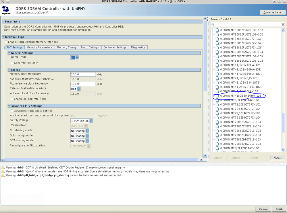

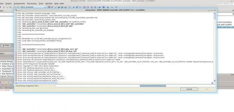

Hey everyone,
Im trying to implement the DDR3 example from the megawizard in quartus 14.1 version.
Im using the Cyclone V Soc development Suite.
in the generation section Im getting those errors:
do you know maybe what is the problem?
(i uploaded the picture seperately for a better display).
thanks,
Ram.

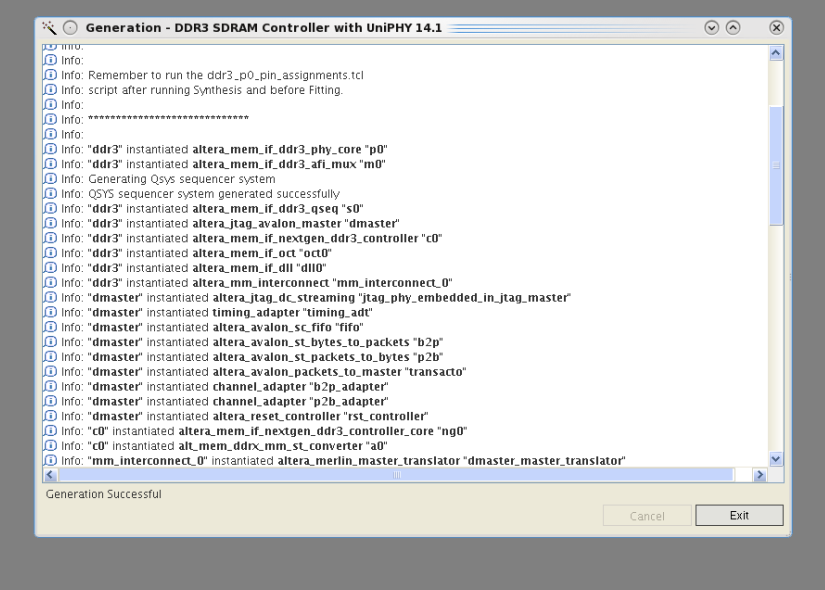

    Hi Ram,
    Thank you for submitting your question in Intel Community.
    I'm Adzim from Penang Global Application Engineer will assist you in this thread.
    I've tried to generate the example design in Quartus v14.1 and the generating process is successfully. I will attach the snapshot.
    I may not use the exact IP parameter setting as your setup.
    It's great if you can share the IP parameter setting for issue replication purpose.
    Adzim

    Hey Adzim,
    thank you for the fast answer.
    Im using the Micron MT41K256M16HA -125 supplied by the Cyclone V Soc development suite.
    the only parameter I changed is the speed grade = 8.
    thanks,
    Ram.

  • AdzimZM_Altera's avatar
    AdzimZM_Altera
    Hi Ram,
    I'm not able to replicate the issue from my end.
    It's looks like a environmental issue when it's shown this errors.
    Have you tried to generate it with different PC that has different OS?
    What is the memory size that operate on your PC?
    Adzim

  • ramsoffer_123's avatar
    ramsoffer_123
    hey to all,
    sorry about the delay. we were in vacation.
    i managed to succeed with that error.
    thank you for all.
    best regards,
    Ram.
    ramsoffer_123
    there was a problem in the installation of the quartus.
