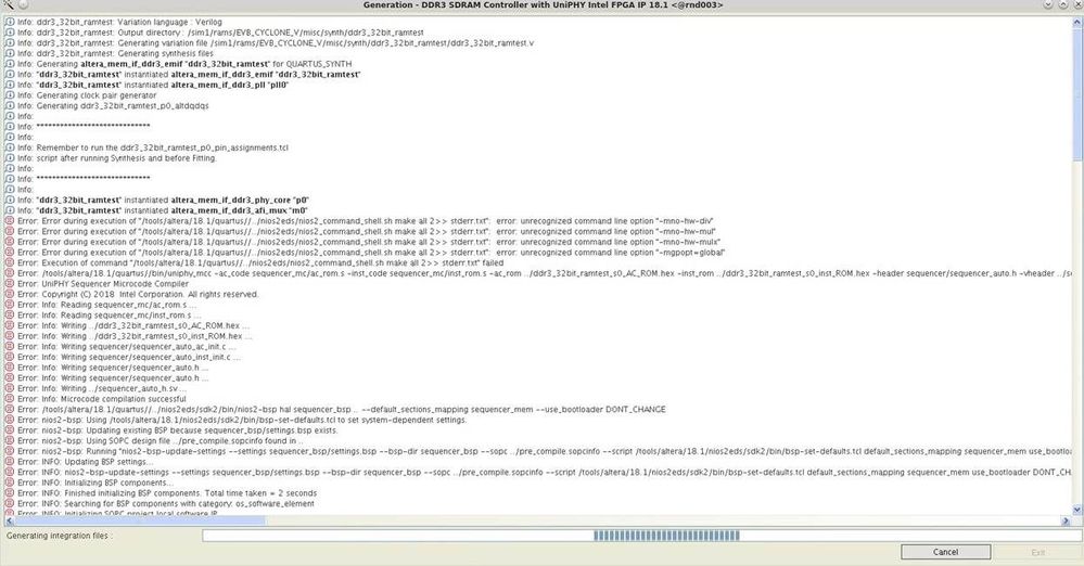

Hey to you all,
I'm using Cyclone V Soc development kit.
also I'm using linux operating system red hat 6.10/7.6.
when I'm trying to generate ddr3 example design I'm getting those errors:

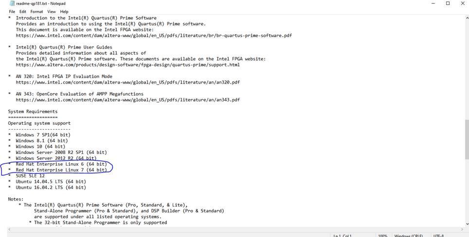

The requirement for operating system according to the readme.txt of quartus 18.1(attached to this call):
it seems to me like an operating system problem.
can you help me to find what is the problem?
