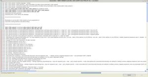

Hey to you all,
I'm using Cyclone V Soc development kit.
also I'm using linux operating system red hat 6.10/7.6.
when I'm trying to generate ddr3 example design I'm getting those errors:
ramsoffer_123
3 years agoHi Adzim,
thank you for your response.
we manage to find the problem.
our operation system used GCC compiler and quartus wants to use CC compiler.
we changed it and the problem solved.
thank you again,
BR,
Ram.
