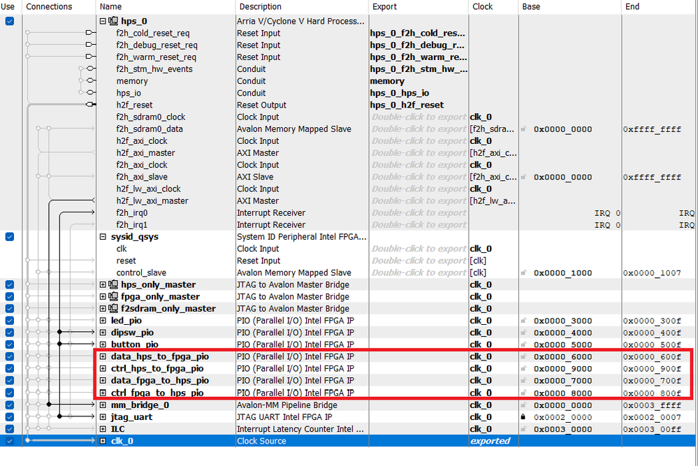

I attached my Platform Designer File.

      In the Qsys File I declared four Parallel IOs. Those are connected to the HPS lightweight AXI bridge via a memory bridge.
      The so called "data_..." PIOs are simply holding data which is either set by the FPGA or the HPS.
      The "ctrl_...." PIOs should handle the communication between the HPS and the FPGA.
      This is handled like this (simple explanation):
      HPS toggles the ctrl_hps_... signal
      Meanwhile FPGA waits for a state change on this ctrl_hps_... signal
      When the FPGA registers the state change by the HPS it reads data from the data PIO and sets its own data to the other data PIO
      After this it toggles its own ctrl_fpga_... signal
      The HPS also (after toggling its own PIO) waits for this toggle by the FPGA
      When it registers the state change it again starts the same communication flow
      It is somewhat like this:
      This is the communication that is happening.
      This is working totally like intended! So everything is working without any error.

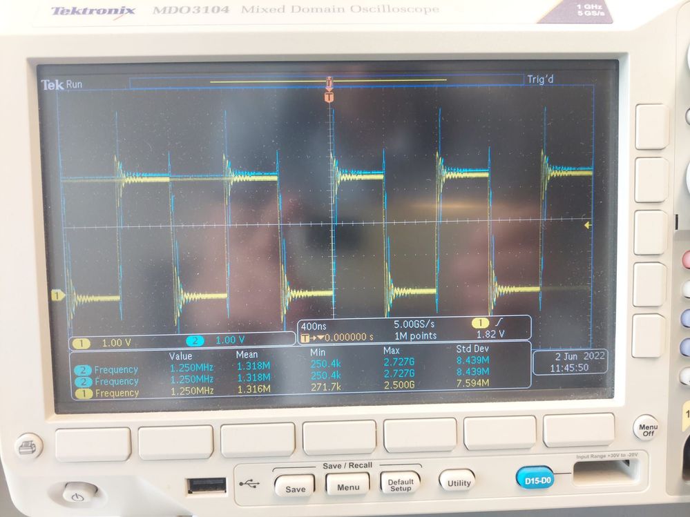

      The highest frequency i can achieve is at around 1.25MHz. But this is only when toggling and not doing anything else, which is not appliable for other projects.
      1.25 MHz Toggle Signal
      You can see that I achieve 1.25 MHz for the Signal Toggles (I routed them to a GPIO Pin thats why there are spikes besides of the oscilloscope quality of course)

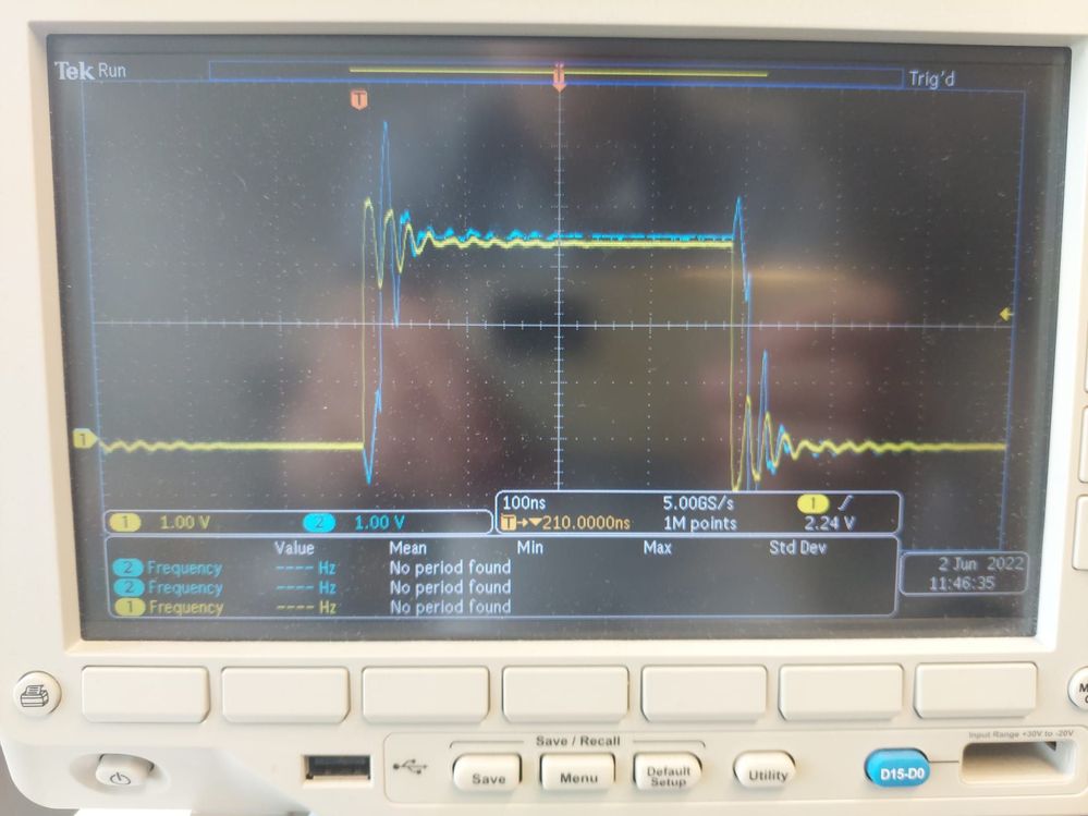

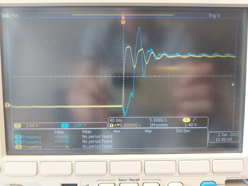

      FPGA toggles 20ns after the HPS Processor

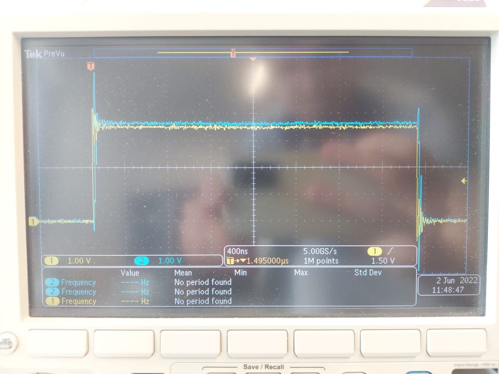

      It can clearly be seen that the FPGA is toggling its own signal (the blue one) 20ns after the HPS has toggled (yellow signal). According to my C Code the HPS should toggle its signal now as soon as it has detected that the FPGA toggled its own signal. But this takes WAY longer than expected. It takes about 400ns for the processor to do so. But the CPU clock is ~1GHz ??
      The processor takes way to long

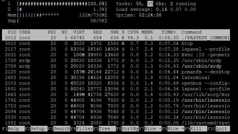

      According to htop when running the code one of the two CPU cores is maxed out at 100% load.

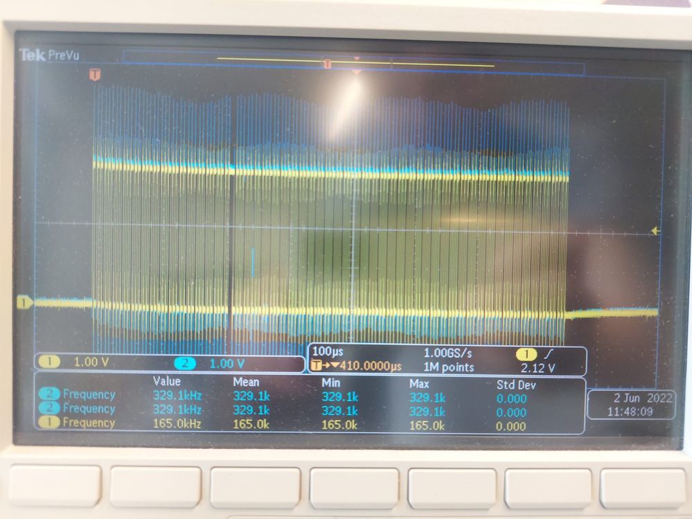

      HOWEVER when checking for the toggle and also do data manipulation (only bit shifting nothing complex) and setting/reading some 32Bit addresses the data rate drops. I transmitted a data frame and according to the CPU time it took 760us to transmit the 1024 values.
      This it the transmission of the data frame.
      Like before the blue signal (FPGA) only takes 20ns to register the toggle of the yellow signal (HPS). The HPS processor however takes "years" to do so. I do not calculate anything to complex. The CPU is only running at around 10% when executing this program.
