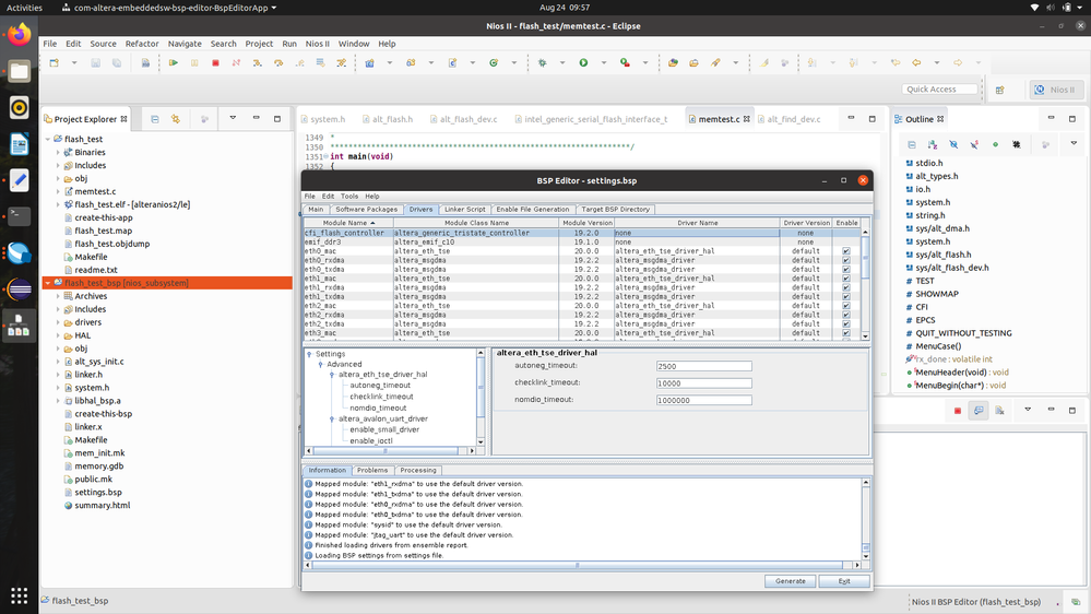

I am working on custom board of Cyclone 10 GX FPGA. I need to test the cfi flash memory & need to have "avalon cfi flash driver" selected in the Driver Name instead of none, as seen in bsp editor. How do I add that. Can anyone suggest a solution. Thanks in advance.
bsp editor tab

I am using Quartus version 20.4. I have loaded the FPGA files based on the instructions from the person who generated the file for Cyclone 10 GX board. He is using Quartus version 22.4 in Windows system. And he is able to detect the CFI flash driver into the Project_bsp--> Drivers, in Eclipse.

From your email, I think the path issue is related to the problem of the folder structure of the project. I have try to include the file(.sopcinfo) to open a hello world project in eclipse but got errors. I think will need to create the project with quartus then generate the .sof and sopcinfo only open eclipse to have a correct folder structure in order to have correct path reference.
