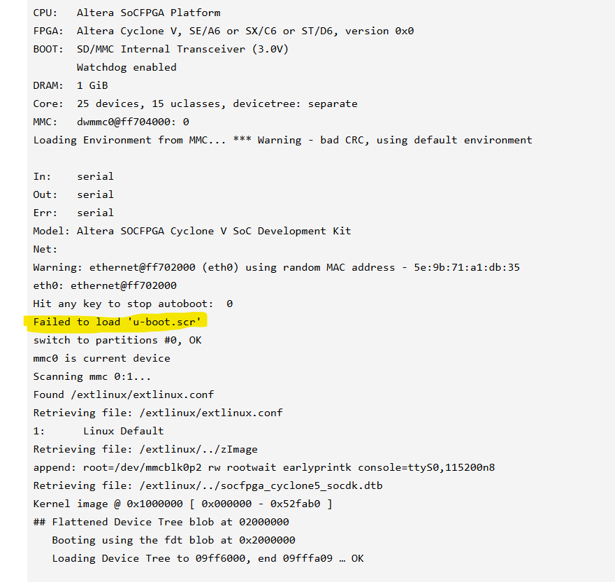

Sorry for the delay on this, checked with Joshua, and he will reply you on the solution. The cyclone V build steps in the rocketboard link above only boot HPS without doing the FPGA configuration.

Your observation is right and we will be fixing this in next update which will be going to Altera FPGA Developer Site.
For now, I suggest the following changes to the steps .

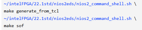

1. For building hardware section (under the "Get the hardware design from github and compile it:") steps,
you may add :
make rbf

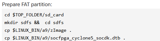

2. For creating sdfs partition in SDcard, add the steps in "Prepare FAT partition:" to include the soc_system.rbf and u-boot.scr file :
cp $TOP_FOLDER/cv_soc_devkit_ghrd/output_files/soc_system.rbf .
wget https://releases.rocketboards.org/2025.03/gsrd/c5_gsrd/u-boot.scrWhile the Building Bootloader page for Cyclone V is not available yet, you may view the GSRD (25.1 as at time of writing) at https://altera-fpga.github.io/rel-25.1/embedded-designs/cyclone-v/sx/soc/gsrd/ug-gsrd-cve-soc/
