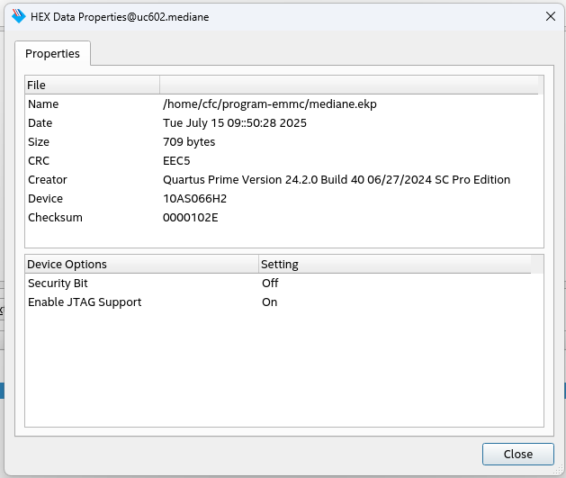

Next, we generate the SPL using the fuse option. With this, the FPGA should only be able to boot if the fuses are programmed (volatile or non-volatile). When alt_authtool.py is executed, it displays the SHA256 hash of the public key. We use this public key to construct a file containing:
key1 3DFE63CAB8B3657DB2EBDEACA234F0D6EC3744A3905D7E04DFA63A5A6721DFE7
Using this key file, we generate an EKP file with Quartus (compressed into a zip and attached to the present message).

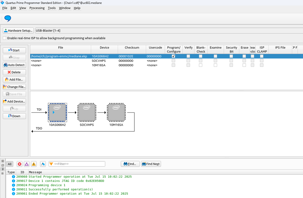

In the end, using the Quartus Prime Programmer, we program the Arria10 board with EKP file (this takes less than one second).
Immediately after programming the volatile fuses, the board resets (the power supply current drops from 1A to 0.8A, and then returns to 1A), and the fan stops and restarts.
==> However, on the serial console, the SPL signed with the FUSE method does not display any messages, and neither U-Boot nor the kernel is loaded.
On the other hand, the SPL signed with the USER method is still able to boot, even with the volatile fuses programmed (boot messages appear, and both U-Boot and the kernel are loaded).

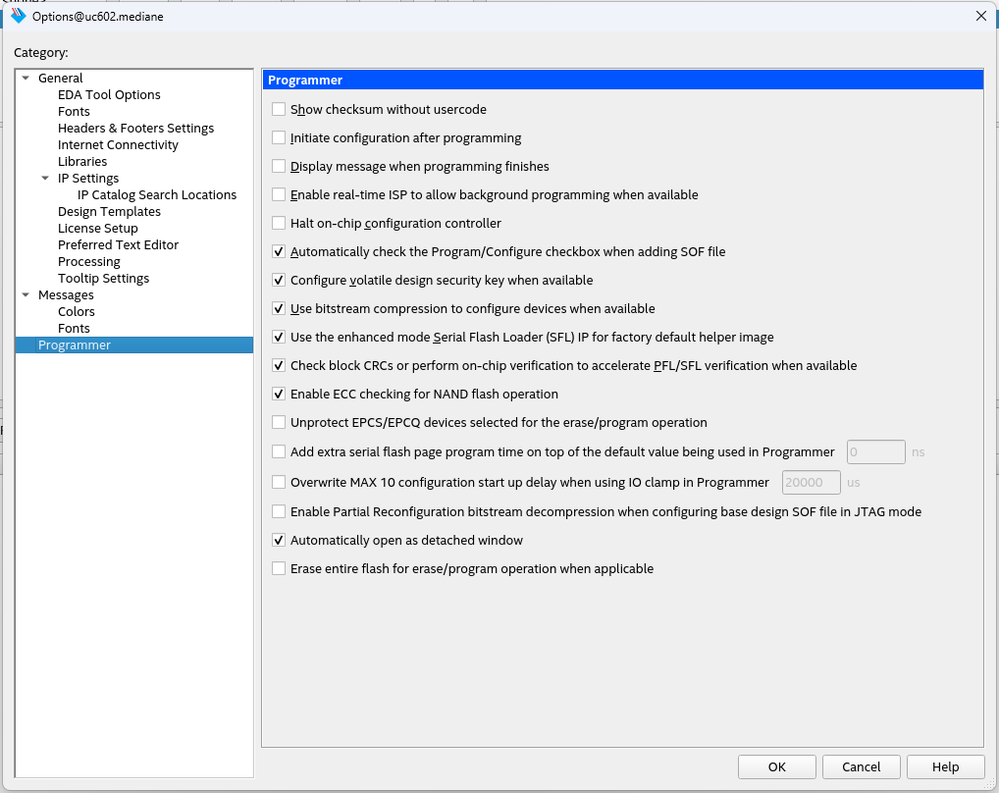

    Preliminary impressions of the issue are, since the board resets after programming the volatile fuses, the saved hash is also lost. Hence, the hash comparison step fails, leading to no prints on the console.
    So, basically we need to avoid reset once the fuse is flashed, this I believe is happening because reset is initiated by the Quartus tool or your programmer.
    There are 2 points for us to check, one with Quartus tool and the other with your programmer:
    1. From my end, I am checking whether Quartus is initiating the reset, and if there is a way to avoid it.
    2. I believe you are using JTAG as your programmer, can you please check if the programmer is initiating the reset?

      1. Just for your information, I was using the Programmer from Quartus Prime 23.1 (Standard Edition), while the EKP file was generated using Quartus Prime 24.2 (Pro Edition). I will try installing the same version to ensure compatibility.
      2. We are using the "JTAG Altera USB Blaster." We’ll investigate the reset pin behavior, but if the reset does not occur, there should be an alternative way to boot the SPL (such as jumping to the entry address directly).
