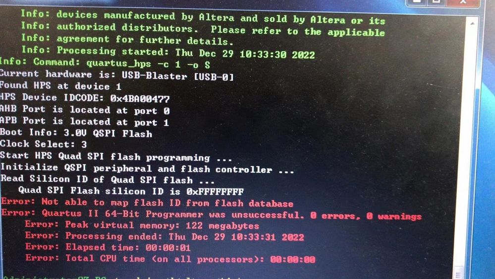

5CSEBA2U无法识别QSPI flash芯片
客户这边使用的soc核心板出现问题,核心板HRST灯一直闪烁无法正常启动,之前装置是现场运行正常的,后来出现问题返修,电源都正常,QSPI芯片也换过新的,FPGA也重新换过,都无法修复,麻烦AE帮忙分析一下问题可能出现在哪。

  • Hi,
    -What is HRST light?
    -How did you perform the power up?
    -You said it was repaired after a problem, what is the problem? What was being the repaired?
    Aiman
