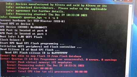

3 years ago5CSEBA2U无法识别QSPI flash芯片
客户这边使用的soc核心板出现问题,核心板HRST灯一直闪烁无法正常启动,之前装置是现场运行正常的,后来出现问题返修,电源都正常,QSPI芯片也换过新的,FPGA也重新换过,都无法修复,麻烦AE帮忙分析一下问题可能出现在哪。

3 years agoHi,
-What is HRST light?
-How did you perform the power up?
-You said it was repaired after a problem, what is the problem? What was being the repaired?
