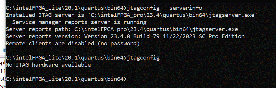

After using my USB blaster successfully with SignalTap to configure and debug my Cyclone4 part, SignalTap and the programming software aren't reliably seeing the USB blaster (by which I mean only 5% ...
