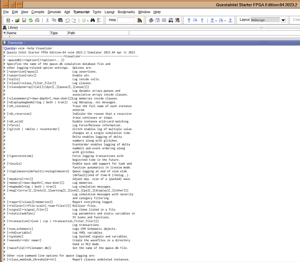

    ShengN_altera
    Yes, Questa Intel Starter FPGA Edition-64 does support Visualizer qwave. Can check with command vsim -help Visualizer. Attached the screenshot for your reference.

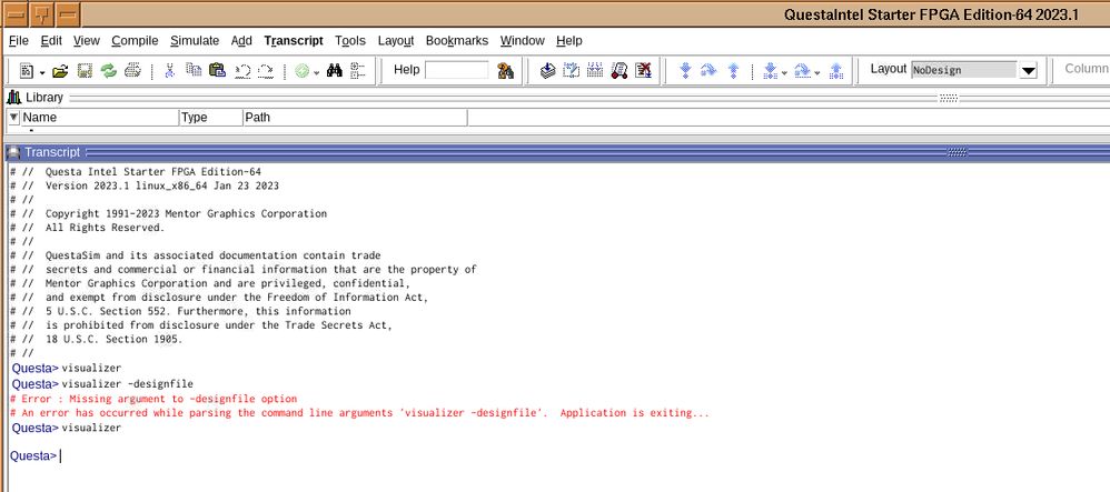

    Thank you Sheng, I'm able to do -help and -version, but anything else results in a license checkout error:
    $ visualizer -version
    2022.4
    $ visualizer
    Could not checkout License for feature 'qdebug'
    Error: Checkout error
    //  License server does not support this feature (qdebug)
    Does it require a special license? I'm able to run vlog,vopt and vsim including generating a qwavedb file. But trying to actually inspect the qwave file results in a license checkout error. This is the questa package which was a part of QuestaSetup-23.1.0.115-linux.run.

    Either one of the license below needed (probably have to get from mentor site):
    modelsim_se-lic
    questasim_sver-lic
    questasim_sysc-lic
    questasim_vcover-lic
    Then only visualizer can be used in Questa Intel Starter FPGA Edition-64 (check image):
