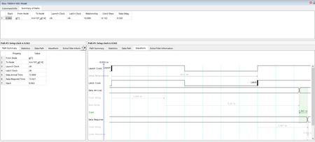

1 year agoWhy does TimeQuest show data arriving after the latch edge?
Here is the waveform from Quartus Prime TimeQuest: I know that the design meets timing since the fmax is more than 100MHz which is the target clock. So this question is specifically about why...
RichardT_altera
1 year agoIt’s not necessary for both the DAT and DRT to occur before the latch edge.
Essentially, we focus on the setup/hold slack, which depends on the both the Data Arrival Path (DAT) and the Data Required Path (DRT). For setup, the DAT must be > DRT. For Hold, DRT > DAT.
