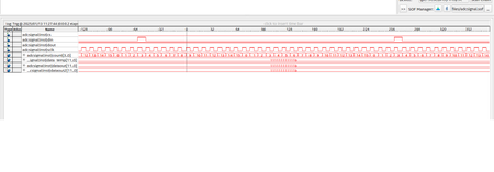

Hello, My project is to convert an analog signal to digital, and I’m using the DE1-SoC ADC for this purpose. I’m trying to achieve this using the code from this video, but despite using the same cod...

Check the attached file.
Please program the .sof first and then program the .elf file. Then open .stp to view the waveform.
Program the .elf file:
1.Go to <path>/nios2eds/nios2_command_shell.sh to open nios ii shell
2.Run command nios2-download DE1_SoC_ADC.elf -c 1 -r -g
That is just a verilog module adc_ltc2308.v and being used in Nios II design.
