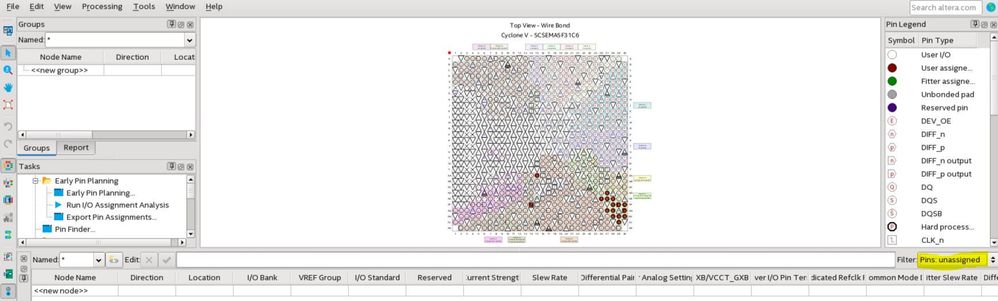

In the pin planner, you can filter the report to pin: unassigned. (highlighted in yellow)
To see a list of unassigned pins.

You can go to Pin Planner to view it.
You can refer to this document for further information.
