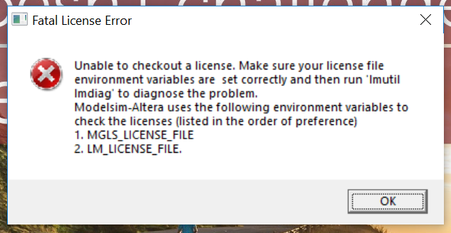

Unable to open ModelSim-Altera edition 10.4b(Quartus prime 15.1). Facing fatal licence error
I have taken the licence for ModelSim-Altera edition 10.4b, I created the environmental variables for the licence, but still I'm facing the fatal licence error. Do I require Quartus prime licence also to run ModelSim? If not what is the solution?

    I have generated licence only for ModelSim-Altera edition 10.4b and I don't have licence for Quartus Prime. The following steps I followed to run the Modelsim with licence,
    1) I downloaded the licence file
    2) I added MGLS_LICENSE_FILE (variable) with variable value given as path to my licence file in "User variables for .. "pane of environmental settings window
    3) I opened the ModelSim-Altera edition 10.4b, and I'm facing the fatal licence error

    I have set the LM_LICENSE_FILE variable, still the problem is not solved. I followed the steps you mentioned for using LMTOOLS and the result is as follows,
    Diagnostics
    FlexNet diagnostics on Tue 11/20/2018 12:41
    License file: C:\Users\HP\Downloads\1-N165UV_License.dat
