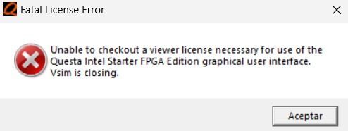

  • AlejandroV's avatar
    AlejandroV
    Hi. I have a problem with the license that involves something from Vsim, I wanted to install the drivers to use Quartus with USB Blaster and when installing the license, now I get an error when I want to simulate Questa, can anyone help me with this?
