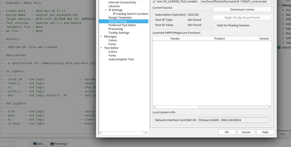

  • robinr's avatar
    robinr
    two nic IDi have two network interface's which may be the reason.. im not sure, but that was a problem when trying to generate a license.
