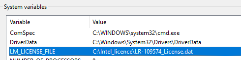

Whenever I launch my Questa, I get this:
The Questa I have :
The environmental variable that I set:

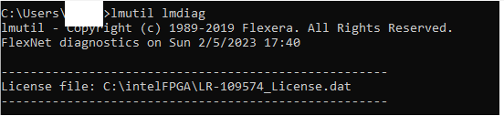

Then running the lmutil lmdiag command :
I don't know how to make it run. It ends up giving me the error. Its not finding the license file not matter what.

    have you looked at the license file to see if it's actually got a license in it? There are several of us in this thread https://community.intel.com/t5/Intel-FPGA-Software-Installation/Has-anyone-succeeded-running-Questa-Starter-with-license-file/td-p/1329811/emcs_t/S2h8ZW1haWx8dG9waWNfc3Vic2NyaXB0aW9ufExEUVBZMlJGTVk1NkhHfDE0NTM0NDN8U1VCU0NSSVBUSU9OU3xoSw
    who found the license files from the self-service license center have no actual license lines, just comments.

      This is correct. I just checked the license files, and they are just comments, no licenses.
