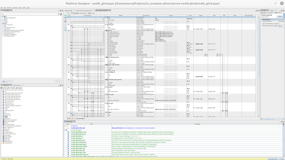

I have a laptop with Ubuntu 20.04, after installed Intel Quartus Prime Std 22.1 and Pro23.1, I found the font and icon size are too small as the attached picture.
Please share the method to enlarge the font and icon if there is.

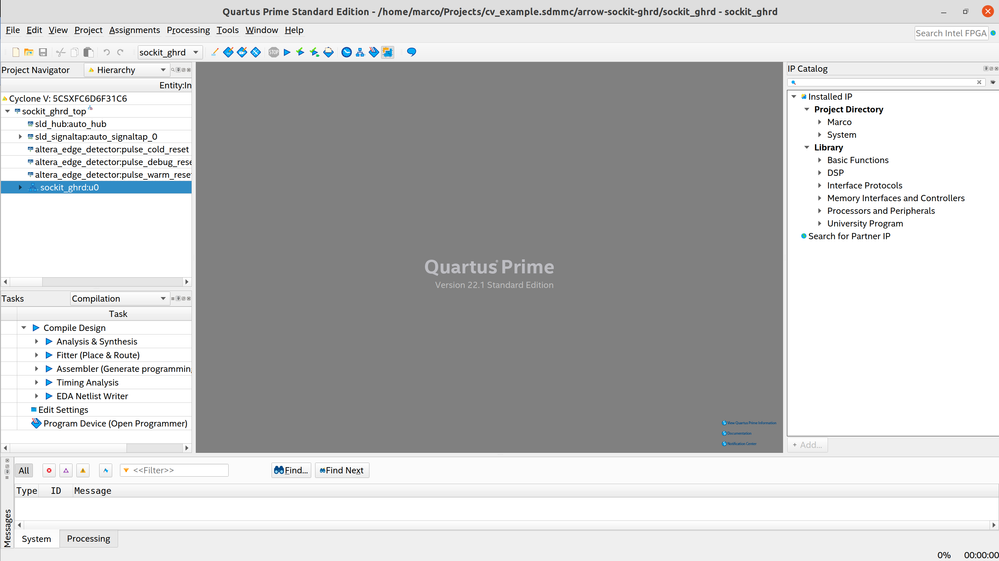

By the way, in Quartus, the size and font are OK.

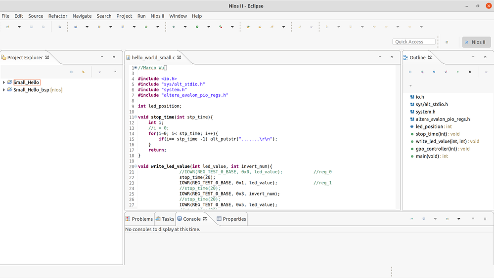

In Eclipe for Nios, the icons are not OK. Need a method to fix it.

- RichardT_altera
I found this article useful on how to change the font size. Please check the attached link.
https://www.macnica.co.jp/en/business/semiconductor/articles/intel/133574/
Regards the Nios II for Eclipse,
1. On the Eclipse toolbar, select Window → Preferences.
2. Set the font size (General → Appearance → Colors and Fonts → Basic → Text Font):
3. Save the preferences.Best Regards,
Richard Tan

- MarcoWu
Hi Richard:
Thanks, with Pro version, it's works. But still no solution for standard verion....>_<...
Best regards
Marco Wu
- RichardT_altera
I'm sorry to hear that, but the Quartus Standard version does not have this capability.
However, you can try changing the font size using your environment variables.
Perhaps this article from Ubuntu may helps.
Richard Tan
