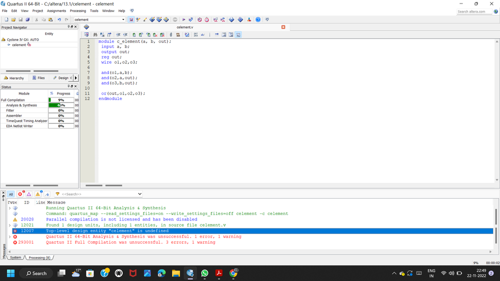

Top Level Design Error in my Verilog code
There is a "top level design" error in my Verilog code. Please mention some instructions to resolve this issue asap.
The code is for a C element in DMR
  • sstrell's avatar
    sstrell
    The name you've specified as the top level entity in your Quartus project (celement) does not match the module name (c_element).
  • As sstrell mentioned, the top level entity name is mismatch with the module name.
    To solve this, right-click the file and set it as Top-Level Entity.
