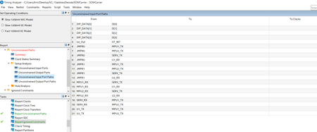

I just had a quick question about False Paths maybe someone could answer? When I generate a report for unconstrained paths and view the "Unconstrained Input Port Paths" I have a report like the pic...

Yes. If these are asynchronous inputs (DIP switches for sure looking at the top of your report), you would false path them:
set_false_path -from [get_ports DIP_DATA*]
for example.

6 years agoYes. If these are asynchronous inputs (DIP switches for sure looking at the top of your report), you would false path them:
for example.

sstrell,
Thank-you for your help! That's what I will do.
