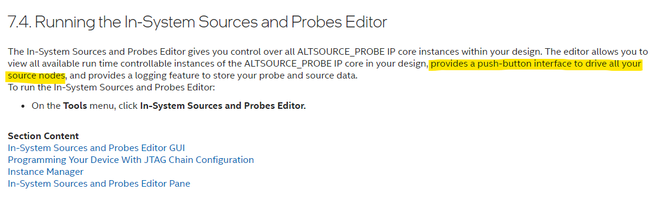

      My problem with ISSP is that if I want to change the sources, I have to do it manually change it bit by bit.
      I have 16 bit input that changes every clock cycle which presents a challenging task.
      I looked at the link ShenN provided and I think I am right to assume that the GUI only allows a direct push button approach.
      What I am really looking for is a way for Quartus to take in a test stimuli in some sort of file format like a text file.
