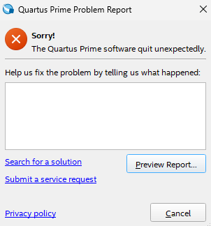

sudden crashes of my Quartus Prime during Synthesis/Fitter
During the implementation of my project from the Quartus Prime GUI (Start compilation), my tool sometimes crashes. A window opens with the message: "Quartus Prime Problem Report - Sorry! The Quartus Prime software quit unexpectedly.....". No specific cause of the error is given.
