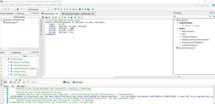

Hi, I had a problem studying verilog alone
The basic code was compiled well as shown in the picture below.

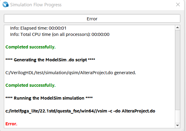

Next, I simulated it, but all the code was completed successfully, but at the end, an error occurred without any explanation.
Below is the full text of the simulation flow progress.

**** Running the ModelSim simulation ****
c:/intelfpga_lite/22.1std/questa_fse/win64//vsim -c -do AlteraProject.do
Error.

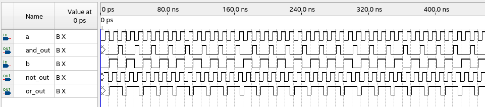

  • ShengN_altera's avatar
    ShengN_altera
    Tested without problem from my site check the screenshot and file attached. May be try to recreate the project.
    Note 1: In vwf, goto Simulation -> Simulation Settings -> Timing Simulation Settings -> delete -novopt -> save.
    Note 2: If you don't get output waveform, try to use older device because vwf is legacy simulator for older device.
    Sheng
