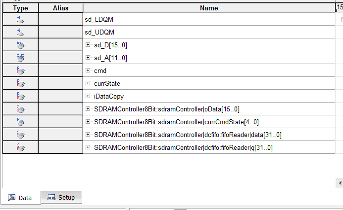

SignalTap: Reordering Nodes
Is it not possible to re-order nodes in the Data view once you set them up?
In the above example I would like to move sd_D and oData so that they are on adjacent rows for example.
I can't figure out how to do this via the GUI. I had a little play around with ordering the XML elements in the .stp file but haven't had any luck (yet).
  • Thanks - that was the first thing that I tried.
    Oh.. I see.. It's a bit buggy. Nothing will drag the first time it's clicked.
    It's not until you select it first and then click again to drag that it works.

    Just click and drag the nodes to reorder them.

    Hi Paul,
    Click the node for selection, then click again and drag to which order you desire.
