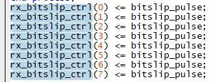

That seems to be what we are seeing on the top row of the signal tap file. For a 12 bit sequence, they show 400, which would be 0100 0000 0000. A single bit slip pulse would move that 1 to the right, so you’d have 0010 0000 0000 which is 200. As you continue to move that 1 to the right, you get 100, 080, 040, 020, etc. I don’t know why these are in 12 bit groups, the max SERDES depth is 10 unless this is SERDES in LEs, not the hard IP. I also don’t know why the sequence goes from 040 to 800, unless they changed the incoming data, or reset the bit slip. Unless you know the incoming data pattern and deserialization factor, signal tap captures don’t help.

Thanks for you explanation. Acctually, my bitslip control seems work well. I just have above wondering.
My deserialization factor is 6. So 8 channel lvds output parallel bit width is 48bit. Two 6-bits will be grouped to 12-bit. The lvds receiver receive outside ADC serial lvds output. The ADC output resolution is 12-bit. As you said, FPGA lvds maximum factor is 10. So I use two 6 factor to process this 12-bit resolution.
