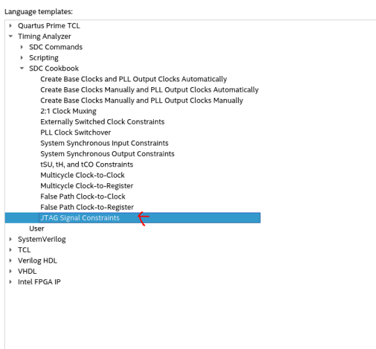

The path below failed the setup timing. The sdc are from the template.
How to fix this setup violation? I am using Quartus Pro 22.3

  • Chris039's avatar
    Chris039
    I am just inserting the Jtag sdc from the template. Do I need to specially constrain the clock signal? Could you share the sdc that I need to add into the file?
