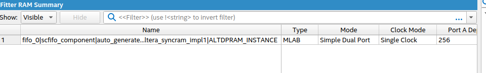

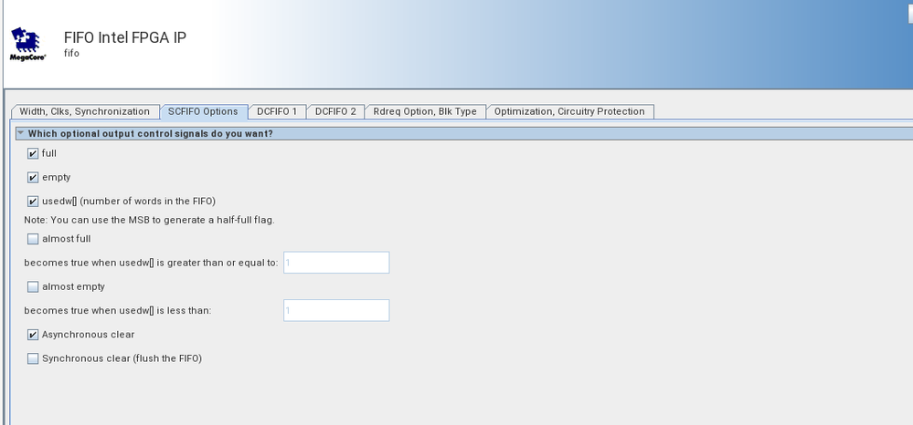

4 months agoI suggest you use FIFO IP SCFIFO options and memory block type set as mlab
The ram report shows mlab only:
