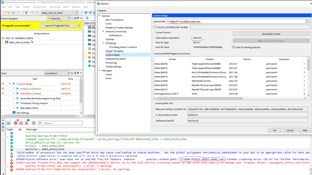

Compiling the Project fails with the above mentioned error, that the license file does not support the 10M08SCU169I7G device. In the attached screenshot the License Setup and the occured errors are displayed.

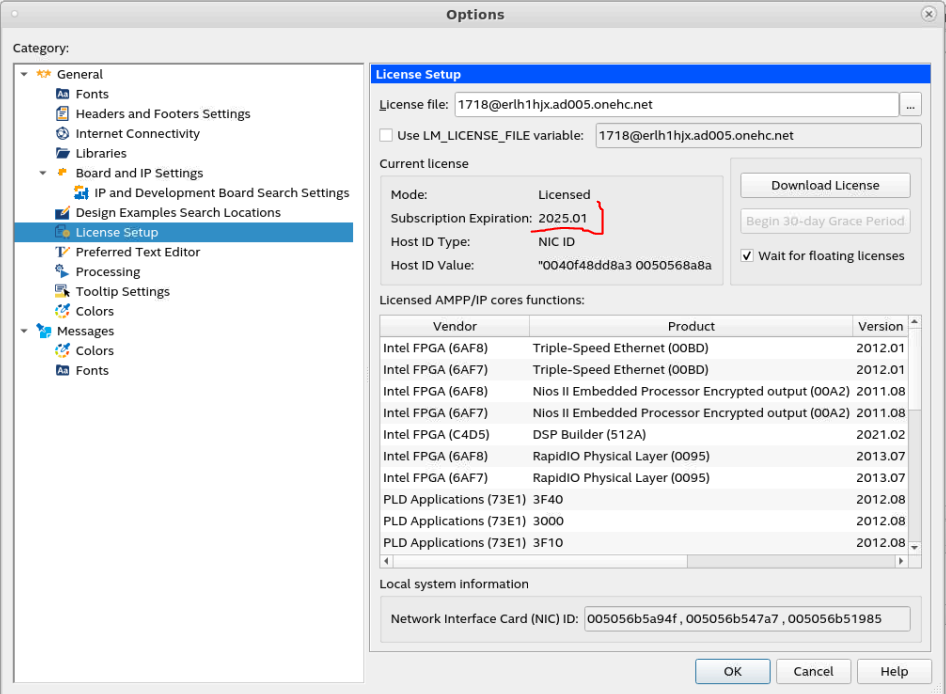

Other colleagues with same tool and license can compile the project. They also have another subscription end shown (2025.1 instead of 2023.1), despite same license server used
How to track this down? - please see screenshots

I don't know a lot about floating license servers, but for some reason your license server is giving you an old license. Whoever is managing your license server should be the one to talk to.
