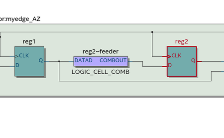

Thanks everyone for the replies.
@FvM: between the output of the LUT (combout) and the input of the FLOP (datain) there is a switch.
Can this switch not be switched to exclude the LUT?
The photo I inserted in the first post is incorrect.
I attach the new one:
I also attach the VHDL code.
This is an edge detector on the falling edge with integrated flops for the CDC:
