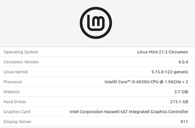

Copy from my original contribution shown below. Hope it helps:I added my PDF steps I followed to get there. Mostly followed the great youtube guide source which might get you there pretty fast is: https://www.youtube.com/watch?v=e5kHFiAVcRI
Ok,,, I think my linux system is all configured up to start coding some FPGA finally.
