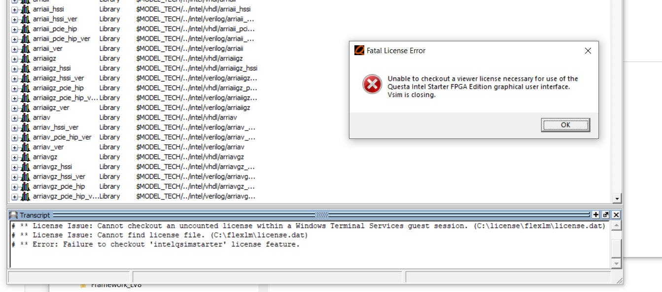

Questa 2021.1, Fatal License Error: Unable to checkout a viewer license
Two weeks ago I "signed up for Evaluation or No-Cost License" for the "Questa*-Intel® FPGA Starter Edition (License: SW-QUESTA).
The simulator was running perfectly. Using LM_LICENSE_FILE variable.
Yesterday suddenly the following error message appeared (see attachment)
Unable to checkout a viewer license necessary for use of the Questa Intel Starter FPGA Edition graphical user interface. Vsim is closing.
How can I fix this issue.
The License file should be valid for 1 Year though?

    Here the erroe message:
    # Start time: 10:00:11 on Nov 17,2023
    # ** Note: (vsim-8009) Loading existing optimized design _opt2
    # ** License Issue: License request for intelqsimstarter feature failed
    # ** License Issue: Cannot checkout an uncounted license within a Windows Terminal Services guest session. (C:\licenses\flexlm\LR-146054_License.dat)
    # ** License Issue: Cannot find license file. (C:\flexlm\license.dat)
    # ** Error: Failure to obtain a VHDL simulation license. Unable to checkout 'intelqsimstarter' license.
    # Error loading design

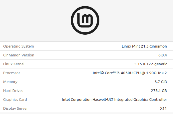

      I added my PDF steps I followed to get there. Mostly followed the great youtube guide source which might get you there pretty fast is: https://www.youtube.com/watch?v=e5kHFiAVcRI
      Ok,,, I think my linux system as all configured up to start coding some FPGA finally.
