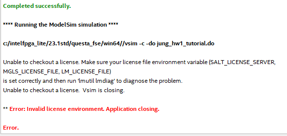

I am using Questa 23.1 Starter Edition to simulate for Quarta Prime Lite 23.1 for a class. I was able to install it but when I ran the simulation. I keep getting the licensing error that I was getting in class which reads "Unable to checkout a license. Make sure your license file environment variable (LM_LICENSE_FILE) is set correctly and then run 'lmutil lmdiag' to diagnose the problem". However, I did the steps to get a free license for Questa and installed it correctly to my computer's environment variables with the correct path as listed in https://www.intel.com/content/www/us/en/docs/programmable/683472/23-4/and-software-license.html .
The one issue that I was confused about was the difference between fixed and float license and what type of computer I have. I was able to find my NicID thats the type I set and I chose a fixed license.
When I run lmutil lmdiag on the win64 file of Questa, it recognizes the license there. The other forum posts' solutions were to make sure the license file is set correctly which I am pretty sure I did. Are there any other steps that I could do to troubleshoot this issue? Thanks! I've also attatched some screenshots.

There is an issue with license generator recently. The license generation issue has been resolved. A fix has been deployed. Could help to request/regenerate again a new license file in self-service licensing center and try it.

I was able to get a new license and it worked, thank you!
