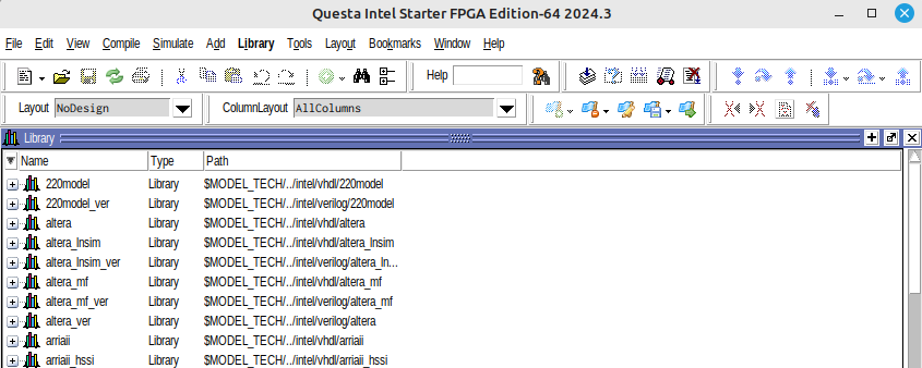

I can now run vsim:
~/intelFPGA_standard/24.1std/questa_fse/linux_x86_64$ ./vsim
Reading pref.tcl

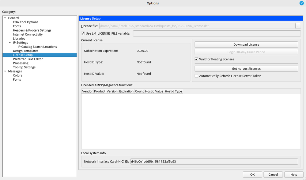

In Quartus, I've done the following setup steps:
1. I configured Assignments --> Settings to include my testbench, Tool name is Questa Intel FPGA
2. In Tools --> Options --> EDA Tool Options I have the Questa Intel FPGA directory set to the default "/home/username/intelFPGA_standard/24.1std/questa_fse/linux_x86_64"
3. In Tools --> License Setup I checked "Use LM_LICENSE_FILE variable"
4. Not that it makes much sense but I also tried the variation where in Tools --> License Setup I uncheck the "Use LM_LICENSE_FILE variable" option and specify the path to the license:
When I now run Tools --> Run Simulation Tool --> RTL Simulation I still get:
** Fatal: Failed to initialize licensing environment. License environment not set correctly.
Unable to checkout a license. Vsim is closing.
** Error: Invalid license environment. Application closing.
In any case I get the above error.
The bottom line is, I manage to load the program by running vsim from the command line as shown above, but even though I made all the steps I've read in the forum, including posts that their subject was similar to this, I still don't manage to load it from Quartus.
How is possible? what can I do?
Any help would be appreciated.
