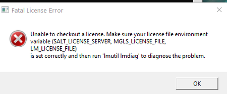

Questa License Issue
- 1 year ago
It turned out there was a conflict with SALT_LICENSE_SERVER. Suggestion from the following link solved my issue.
Solved: Re: Questa License Issue - Intel Community -- "However, if a salt_license_server enviroment variable is present, because other Siemens software has created it, Questa is only checking this variable and skipping lm_license_file and mgls_license_file variables. The solution is to add the Questa license file to the salt_license_server entry."
