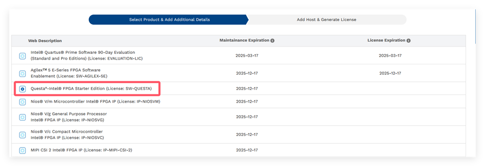

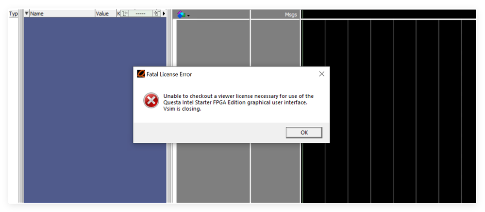

I applied Questa license from Intel® FPGA Self-Service Licensing Center, set the LM_LICENSE_FILE environment correctly on PC, when run RTL Simulation, I got the error "Unable to Checkout a viewer license necessary for use of the Questa Intel Started FPGA Edition graphical user interface. vsim is closing".
How to fix this issue? Thanks in advance.
  • sstrell's avatar
    sstrell
    License files were getting generated incorrectly recently (all lines of the file strangely commented out). Try regenerating your license file at the SSLC.
  • BXia's avatar
    BXia
    I fixed the error, it isn't due to the license.
    I set the license on a PC, but remotely login it, then the error got while simulating remotely.
    I login the PC directly and simulate it without any error now.
