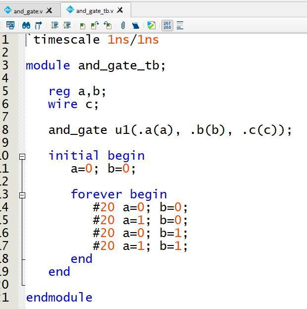

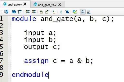

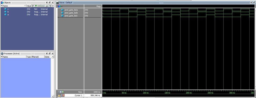

I used Cyclone IV (EP4CE6E22C8), and the delay should be 9ns. However, my Gate level simulation's delay was 0. What should I do?

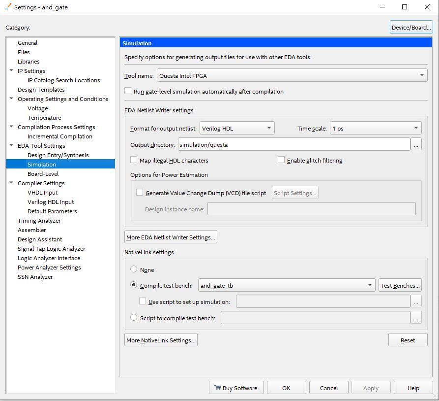

I'm missing the step where you import the gate level netlist.
- sstrell
It doesn't look like you are running a gate-level sim. It looks like a standard RTL sim.

Finally, I found that I should turn off "Generate functional simulation netlist", then the gate level simulation will display correctly.
