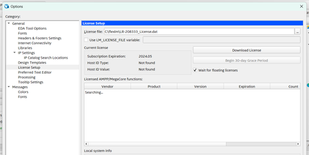

Hello Intel Community - In October 2024 I successfully installed and licensed (fixed) Quartus Prime Lite Edition and Questa-Intel FPGA on my Windows desktop. I've recently tried to repeat this pro...

Did you recently generate the file? Other posts were showing that the license generator was not creating proper files (everything was commented out). Maybe you need to regenerate the file.- GuessWho1 year ago
Thanks for this tip! I regenerated a fresh license file and this issue was resolved.
*Please note... I did have to use the environmental variable method this time around and a computer restart was required to get Questa operating properly.*
