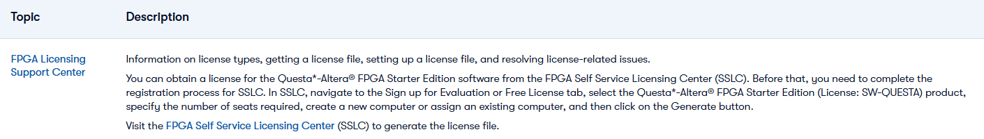

I have also followed this instruction to set up a Fixed license:
But, I still have the same error when I open Questa. Please advice. Thank you
