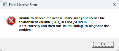

I am trying to get this simulator to work with a fixed license file but when trying to open it I get the licensing error shown below
Currently my environment is configured so that environment variable LM_LICENSE_FILE points to the .dat fixed license file. SALT_LICENSE_SERVER environment variable doesn't exist in my environment.
Am i missing anything regarding the configuration of my environment?
Could somebody please help me solve this licensing problem?

    It appears that the version of Questa you have installed no longer reads the LM_LICENSE_FILE variable. Newer versions of Questa® Altera® FPGA Edition require the license to be configured using SALT_LICENSE_SERVER instead.
    Please follow the instructions under “Setting Up the Questa® Altera® FPGA Starter Edition Software License” for your operating system (Windows or Linux) in the link below:
    https://docs.altera.com/r/docs/683472/25.3/altera-fpga-software-installation-and-licensing/questa-altera-fpga-edition-and-questa-altera-fpga-starter-edition-software-license
    > That’s expected. The SALT_LICENSE_SERVER environment variable does not exist by default—you will need to create it manually and set it according to your license configuration.
    Additionally, please verify that the license.dat file contains the appropriate feature for your edition:
    intelqsim → Questa® FPGA Edition
    intelqsimstarter → Questa® FPGA Starter Edition
    intelqsimstarter will Not works for Questa® FPGA Edition.
