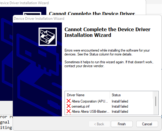

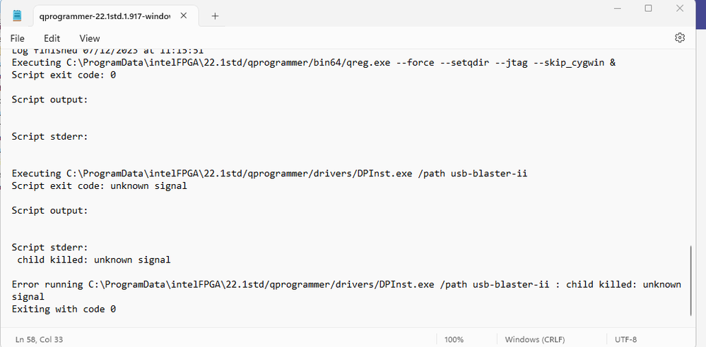

While installing QuartusProgrammerSetup-22.1std.1.917-windows on Win11, the final step of installing Device Driver Installation Wizards reports that "Install Failed". Please see attachments.
Any help with resolving this issue would be appreciated.

That might happened when you perform any operation that invokes a Windows File dialog, such as File > Open.
Kindly refer to the KDB below for workaround:
https://www.intel.com/content/www/us/en/support/programmable/articles/000093658.html
