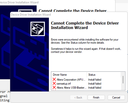

3 years agoQuartusProgrammerSetup-22.1std.1.917-windows failing to install USB Blaster II drivers on Win11
Hello, While installing QuartusProgrammerSetup-22.1std.1.917-windows on Win11, the final step of installing Device Driver Installation Wizards reports that "Install Failed". Please see attachments...

3 years agoHi,
That might happened when you perform any operation that invokes a Windows File dialog, such as File > Open.
Kindly refer to the KDB below for workaround:
https://www.intel.com/content/www/us/en/support/programmable/articles/000093658.html

Hi Aiman,
Thank you.
