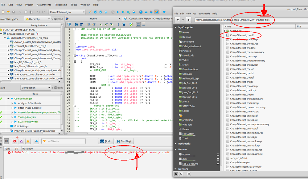

Quartus18.x issue2: lost path to files on project reopen.
Platform Linux mint 17.3 I7 Sony Vaio 12GB ram.
Project when reopen lost file link with an error file not found.
File is still at same position on myIP folder.
same if file is open on a non project path or output files.
This issue appeared when two Quartus instance where opened at same time.
After that also all setting of editor and program got lost.

      I found opening two instance caused some trouble.
      I probably launched as root to check if programmer issue was related to some access right.
      Launching as root from user file on ~.altera.sbt4e get owned by root privilege.
      Restoring access to group and user cleaned up some issue on settings save restore.
      File opened on path different from design folder report this.
      Ex: File where opened from IP cores folders or synthesis, or output as reported, never open back.
      Roberto

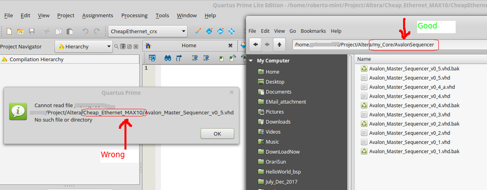

    Hi Roberto,
    Do you mean that this error occurs when more than one instance are opened and giving root access solves the problem?
    In the screenshot provided, the path in the error message is /Project/Altera/Cheap_Ethernet_MAX10/Avalon_Master_Sequencer_v0_5.vhd. The exact location of this file is /Project/Altera/my_Core/AvalonSequencer, which is different from the path stated in the error message. Can you remove the file in the software and add the file from the correct location?
